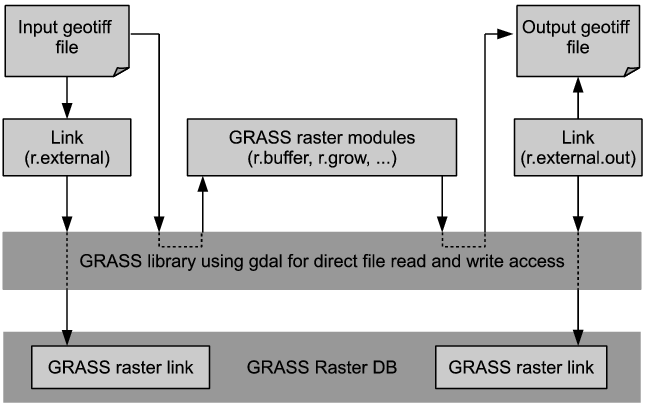

Hello,
i have created a simple graphical model of the r.external work-flow,
attached as PNG file. (for presentation purpose)
If this is correct, i can add this to the help-pages or Wiki?
Soeren
To be honest, I found that diagram rather confusing.
I think that it would be better to explain in words what r.external
and r.external.out do.
