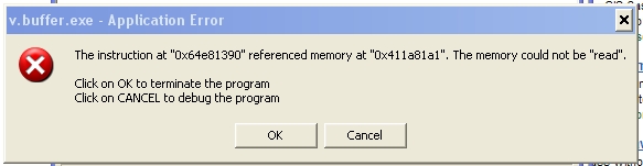

I am trying to use v.buffer to create anisotropic buffers around polygons,
and it doesn't seem to work. Example command included below, and error
message attached. I am running 6.4.0 on Win XP.
v.buffer input=AltPolys@MAPSET1 output=t1 distance=500 minordistance=100
angle=45
The ability to create anisotropic buffers seems like a great recent
addition, and I am using it quite effectively for points, maybe just isn't
setup for polygons?
On Linux, this seems to work.
