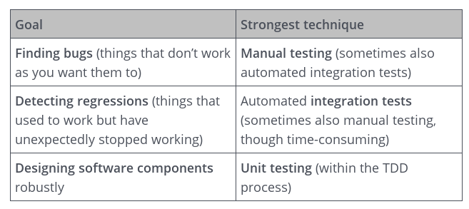

Then i live in a parallel universe. Simple question: How do you test your software? How do you assure the correct functionality of your software? Why is it impossible to implement your approach of testing in a dedicated gunittest? How do you assure software quality, if you don’t provide tools so that other developers are able to test your software for correctness? Regression tests are not possible then, because the effect of changes in the core libraries can not be easily detected in modules without tests.
Can you explain to me why the developers of the sophisticated software system VTK [1] implement unit and integration tests for all software components to assure the correct functionality of the framework? They didn’t saw the trap? They are delusional to think that tests assure software quality?
Why is test driven development [2] an integral part of agile software development approaches like scrum or extreme programming? They didn’t saw the trap? They are delusional to think that tests assure software quality?
[1] http://www.vtk.org/overview/
[2] https://en.wikipedia.org/wiki/Test-driven_development
However, I do agree that these tests are useful in detecting if any changes to the code change the output, thus raising a flag that the developer has to at least take into account.
I’ll try to write some tests for the OBIA tools when I find the time, although I do agree with Markus that it wouldn’t be useful to try to write tests that would cover each and every possible corner case…
Why is it “not useful” to write tests for all cases the software is dedicated to solve? It is indeed a lot of effort, but it is useful.

I also like the table close to the top of
http://blog.stevensanderson.com/2009/08/24/writing-great-unit-tests-best-and-worst-practises/
(attached as image)

http://www.rbcs-us.com/documents/Why-Most-Unit-Testing-is-Waste.pdf
(attached as image)
