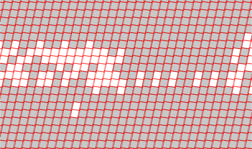

Hi,
2016-12-22 18:43 GMT+01:00 Markus Neteler <neteler@osgeo.org>:
So does this affect the display then? I see holes in the map where I
would expect tiles (and QGIS shows them).
yes, d.vect in wxGUI displays by default, points, lines, and areas.
See screenshot bellow, in red are boundaries (d.vect type=boundary).
Ma
