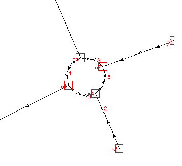

Attached a small map with a roundabout and a screenshot.
The idea is that you cannot go clockwise in the roundabout
(continental European directions).
Still GRASS suggests this...

# If you now start in the south bound street and route clockwise
# in the roundabout, GRASS happily permits this :frowning:
