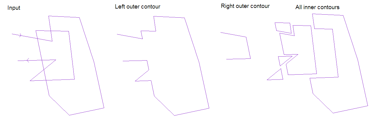

Hi all,
This week’s productivity was again low because of me studying for final
exams. Luckily they will be over in a few days.
Here’s a brief description of the algorithm for generation of type B/C lines.
1.Get input line (n points)
2.Add points to the line in every self-intersection. As a result we don’t have any intersections on the inside of line segments. /currently: O(n^2) time; optimal: O(n*logn)/
3.Extract outer and inner contours /currently: approx O((n+k)^2) time; optimal: approx O(n+k); k is number of self intersections/. See attached image for idea of contours.
4.Create parallel line(s) for outer contour(s). /We have left and right outer contour when both line ends are not in a loop. Otherwise the outer contour is only one/
4’./Type C lines only/. Create a parallel line to every inner contour.
5.Remove ALL loops in the created parallel lines. Some inner parallel lines might be completely removed.
Here’s how we’ll use this for buffer generation.
6.Add “caps” to the line ends. Outer parallel line is the buffer area’s border. Inner parallel lines are buffer area’s holes.
Today I’ll start implementing step 5, since the 1-4 seem to work fine. Next week I’ll be implementing and testing the above algorithm. As soon as I finish it, I’ll start making optimal versions of the functions, since these will be slow on big inputs. Step 2 will be done in O(nlogn) using a line sweeping algorithm.
No blocks yet, except of exams.
See this thread for some idea of type B/C lines:
http://lists.osgeo.org/pipermail/grass-dev/2008-June/038334.html
Rosen

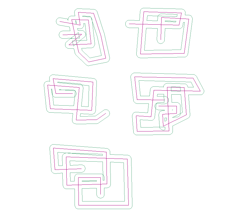

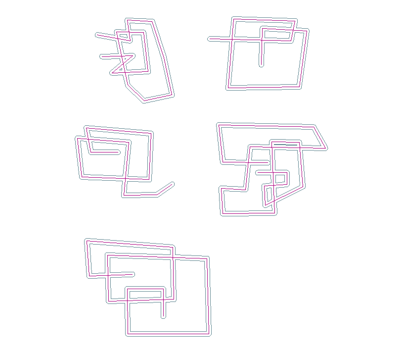

Hi,
Did I really wrote that I'm at step five? Now I am really there
(hopefully), after a weekend of rewriting code, a lot of silly
mistakes and debugging. I'm very happy with the results. You can see
them by yourselves. Next step in my work is to remove those nasty
loops (like in not_so_cool.png). I was thinking how to do that and
came to the conclusion that it will be trickier than I originally
thought. (Having said that, I must also note that most of the things
I've already dealt with proved to be harder than I originally had
thought :). Maybe that's not surprising. )
Happily,
Rosen

Hi,
This week I managed to finish the part, which generates parallel lines
to all the inner and outer contours of the input line. You probably
already saw that, as I posted images. I figured out the algorithm for
the final phase (the cleaning of extra loops). It's a matter of hours
for me to implement it and test it. It has running time comparable
(and less) to previous parts of the whole algorithm, so it won't be a
bottleneck. Moreover, it doesn't have the flaws of the old
implementation. My task for the weekend is to finish the final part
and integrate the whole thing into v.buffer2. It should be pretty
straightforward process and I don't expect difficulties. Then I'll
update the documentation, so that it covers the new features. There
were some minor blocks this week and they were resolved.
Regards,
Rosen Matev
