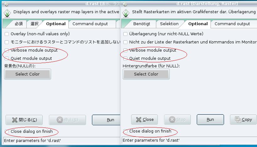

Hi,
some messages (see below/screenshot) are not shown in translation. They are
coming from grasslibs_XX.po and are translated in JA and DE but still appear
in English. Somehow the translations are not propagated to the wxGUI.
Martin has indicated to me differences between
grass64/lib/gis/locale.c
and
grass70/lib/gis/locale.c
Anything to sync here?
Markus
(attachments)
In 6.x, those strings aren't localised in G_usage_xml(). Try r41031
(for 6.5).
Glynn Clements <glynn@gclements.plus.com>
On Mon, Feb 15, 2010 at 3:02 PM, Glynn Clements
(for 6.5).
This helps, backported.
Yet another one is there (DE example):
#: ../gui/wxpython/gui_modules/menuform.py:871
#: ../gui/wxpython/gui_modules/preferences.py:1131
msgid "Close dialog on finish"
msgstr "Schließe den Dialog beim Beenden"
But they are indicated correctly:
[neteler@north grass64]$ grep 'Close dialog on f' gui/*/*/*
      label=_('Close dialog on finish'), style = wx.NO_BORDER)
label=_("Close dialog on finish"),
To get things like
   'label=_("Close dialog on finish")'
shown translated in the file preferences.py, I had to add the "import gettext"
stuff (yet unsubmitted).
Looking around I found other .py files lacking the gettext stuff.
What's the right way to do it? Add everywhere or is there a better way?
Or can it be inherited from globalvar.py or another file?
Before cluttering files, I thought to ask.
Markus
> (for 6.5).
To get things like
For any process, the __main__ module (the one which is executed rather
than "import"ed) should call gettext.install. This inserts the "_"
function into the global namespace.
The call in wxgui.py should be sufficient for the GUI itself, but
menuform.py also requires it for the case where it is executed from
G_gui().
IOW, any module which uses:
  if __name__ == '__main__':
(other than for debug/test/demonstration purposes) should call
gettext.install within that section of code (calling it from the top
level is suboptimal, but probably harmless).
On Wed, Feb 17, 2010 at 8:10 PM, Glynn Clements
G_gui().
   if \_\_name\_\_ == &#39;\_\_main\_\_&#39;:
So, I would add it after __main__ in:
svn status gui/wxpython/
M gui/wxpython/gui_modules/location_wizard.py
M gui/wxpython/gui_modules/mcalc_builder.py
M gui/wxpython/gui_modules/render.py
? This would also activate preferences.py?
I am not on my development machine, so I cannot test.
Markus
I don't know enough about the GUI and GUI-based startup to know which
files are executed. The GUI itself is wxgui.py, while G_parser()
executes menuform.py. Other than that, I don't know.
gettext.install makes "_" a built-in function, so it's then available
for all modules.

I have submitted the fixes, now missing strings are translated.
Markus
