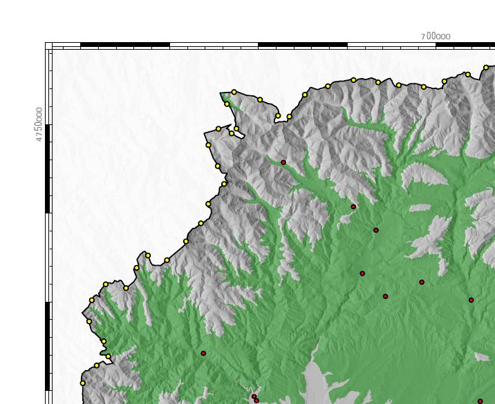

Hi all,
I present two new features in ps.output (soon in grass-addons) as you see in
attach:
- transparent colors. This is possible only using ghostscript (with standard
postscript is not implemented) via -g flag of ps.output, but you can traslate
to PDF 1.4 to retain transparency.
- eps symbols along a line or boundary with a constant separation. Perhaps,
this is not prefect but work fine in my simple test maps.

Thanks Dylan,
No completely vector-based, obiously the raster map is a bitmap, but all lines
and the green area with transparent color are vector based. I send you a
screen snapshot of a 400% KPDF magnification (this attach with grey n, see
below) to test quality.
For the moment ps.output is a grass-addon different of ps.map but trying to
retain similar script files. For example, to draw the attached map the kernel
code of the script is:
ps.output -g out=$OUTPUT.ps << EOF
[... paper, grid, maparea, not commented -- in general just in
grass-addons ...]
raster 30m.3d@bierzo <- raster in the main area (dark gray)
  grey y <- draw raster in greyscale (this attach N)
  maskcolor 200:200:200 <- tint of the raster background (outside main area)
  maskcell mask@bierzo 30m.3d@bierzo <- mask of main area and raster for
                                background (here the same as the main area)
end
vareas cs_lim@bierzo <- vector map of the green area
  line <- style of the limit line of the area
    width .1mm <- line width
    color none <- no color = no line
  end
  fcolor 0:130:0$.5 <- fill color 0:130:0 = green, .5 = transparent 50%
end
vpoint bz_lim@bierzo <- boundary of main area (El Bierzo, spanish region :slight_smile:
  type boundary <- this is vpoint but use along boundary
  symbol basic/circle <- symbol to repeat
  line <- style of the line of the symbol
    width .3mm
    color black
  end
  fcolor yellow <- fill of the symbol
  size 3.5 <- scale of the symbol
  dist 20 <- separation between symbols (for the moment, points)
  cline <- style of the conection line
    width .3mm
    color black
  end
end
vpoint meteo@bierzo <- vpoint type point (default)
  symbol basic/circle
  line
    width .3mm
    color black
  end
  fcolor red
  size 3
end
EOF
Many new features are just in grass-addons ps/ps.output with new styles of
grids, etc.
The new features are not in grass-addons because I am testing and cleaning the
code for transparent colors (all colors are named or red:green:blue$alpha
colores -lines, areas, patterns, symbols, etc), and for symbol along lines (I
develop the code in the last 2 days).
All new ideas to improve the postscript output of GRASS are wellcome.
The idea of symbol along lines if from the INT1: "symbols, abbreviation and
terms used on charts" of the Organisation Hydrographique International -- to
can draw their area limits, railways, overhead transporter, dykes... :slight_smile:
