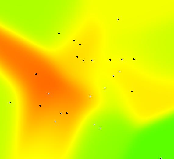

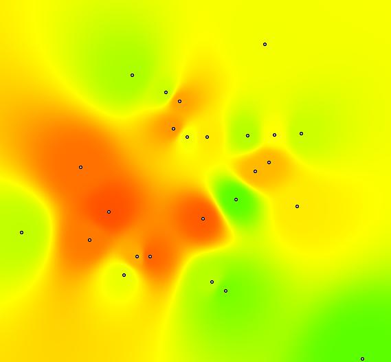

Hi Benjamin,
I am always in favour of more interpolation methods,
but could you explain a little more about the advantage
of your weight term versus that of classical IDW?
The only advantage is avoid the classic circular spot (attach idw.pow.jpg).
The IDW use a weight = 1/d^2, (Hyperbolic) with infinite value when d -> 0.
This result in a circular pattern, with other interpolation method it is
possible obtain a weight average of the points with d near zero (the
particular point has not the original value, good for robust estimation).
If weigth = exp( - distance^2 / bandwidth^2) Then, when d->0 weigth -> 1, no
infinite as in IDW
This is only a proposal to discuss new interpolation methods more interesting
than inverse squared distance.

So do I understand right that the weight gets smaller
as the bandwidth gets larger (given constant distance)?
Yes. Now, no default bandwith distance. Very lower values result in single
points (perhaps fill with global average?), lower values is similar a voronoi
triangulation (attach idw.baw1.jpg), high values result a smooth
interpolation (attach idw.baw2), very high values is a weighted average.
