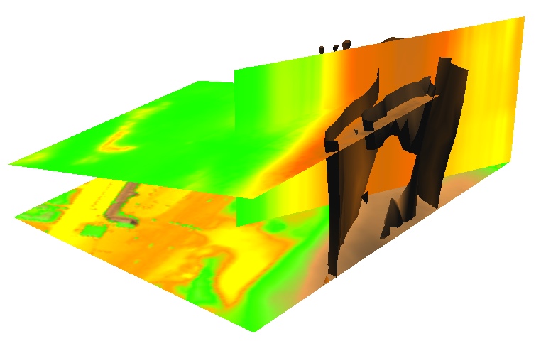

We are trying to work with some volume data and we haven't been able to find a module that
would actually create a color file for grid3d.
Apparently nviz reads the colors from the color table if it is present
http://trac.osgeo.org/grass/browser/grass/branches/develbranch_6/lib/ogsf/Gvl3.c
and the G3D library provides functions for color support
http://grass.osgeo.org/programming6/g3dlib.html
G3D Color Support
Applications can use the standard grass functions to work with colors, except for the file manipulations.
int G3d_removeColor(char *name) Removes the primary and/or secondary color file. See G_remove_colr for details.
Returns always 0.
int G3d_readColors(char *name, char *mapset, struct Colors colors) Reads color file for map name in mapset into the colors structure. See G_read_colors(Raster_Color_Table) for details and return values.
int G3d_writeColors(char *name, char *mapset, struct Colors colors)Writes colors stored in colors structure into the color file for map name in mapset. See G_write_colors (Raster_Color_Table) for details and return values.
but there is no r3.color (based on r.color?) and rather surprisingly v.vol.rst does not create a color file (as v.surf.rst does),
neither do r.to.rast3 or v.to.rast3 (those probably are OK to use the default colors).
I assume that writing or copying a color file into the relevant grid3d directory would work (I can try it out),
but that is not a solution for normal users - I am wondering how difficult it would be to write r3.color module,
to make the colors on 3D rasters adjustable
Helena
just a follow up that copying a suitable color file to the given grid3 file directory works
and creating a pretty complex visualization with cut-off slices and isosurfaces was surprisingly easy
(there is apparently a small bug in the GUI when entering the value for isosurface - it does not
allow me to type anything until I accept it empty and re-open it - other than that it worked great).
This was with the Tcltk nviz - as far as I remember slices are not supported in wxnviz yet.
Suzanne, I will email you more details on how to modify your colors,
Helena
