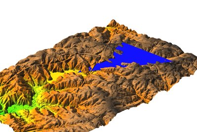

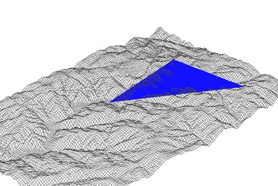

Hi Adam,
(sorry if you already got this email)
I am not sure if this is exactly what you want but have a look at the
attached screenshots. This is done in wxNviz. I created a plane (3
points) with
v.in.ascii -n input=inputFile.txt output=out format=standard separator=" " z=3
The file containes what you already used (F 4 ...). Then you can
display it in 3D view. However, the transparency of the surface is not
working well together with the vector. You can play with using wire
style as in the
screenshot. If it is not clear, just ask for more details.
Regards,
Anna
