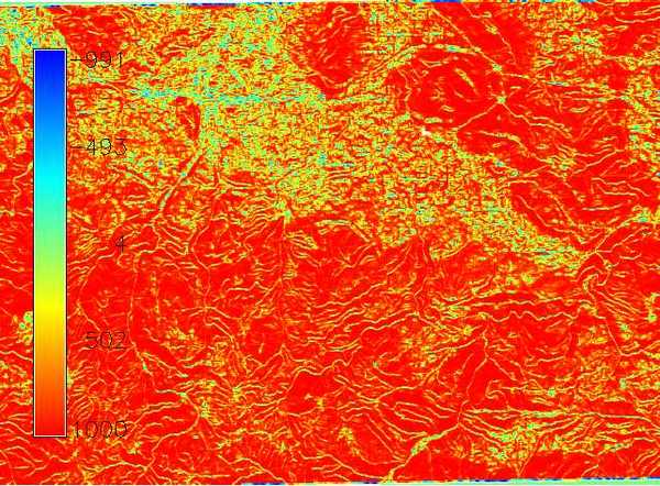

hmm, interesting - I assume it is the same behaviour and due to the larger
area I am working on, my shift is more pronounced.
Attached a jpg of r and elevation.dem correlation (Moving Window size 3x3
multiplied with 1000) - the deviation from 1000 (or corr. val 1) is just
present in parts of the image - I would have assumed that the whole image has
a constant deviation from 1000, hence there might be another error.
Martin
