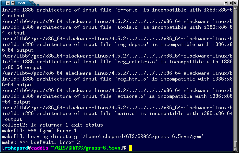

On Sat, 21 Jan 2012, Glynn Clements wrote:
It's impossible to say without more information (e.g. exact errors
messages).
Hi, Glynn!
   A screenshot is attached. Please let me know if I can provide more
information.
Thanks,
Rich

On Fri, 20 Jan 2012, Rich Shepard wrote:
I ran 'svn up' on the grass-6.5 directory on my laptop running
Slackware-13.37/x64, then configured and tried building. The make fails
because the main.o is 32-bit not 64-bit.
   FIXED: deleted all files in the grass-6.5svn/ directory then checked 'em
all out again instead of updating. Built with no errors.
Rich
Rich Shepard wrote:
   Of course! I should mention that GRASS 6.5svn successfully built on this
laptop before. I ran 'svn up', configured, and tried to make it.
There should have been a "make clean" step in there somewhere.
Whenever you update the source code or re-run cnofigure, you should
always run "make clean".
Glynn Clements <glynn@gclements.plus.com>
On Sun, 22 Jan 2012, Glynn Clements wrote:
There should have been a "make clean" step in there somewhere. Whenever
you update the source code or re-run cnofigure, you should always run
"make clean".
   Yep. And that's what I forgot to do just after the previous build. Sigh.
I'll try to not make the same error again.
Rich
