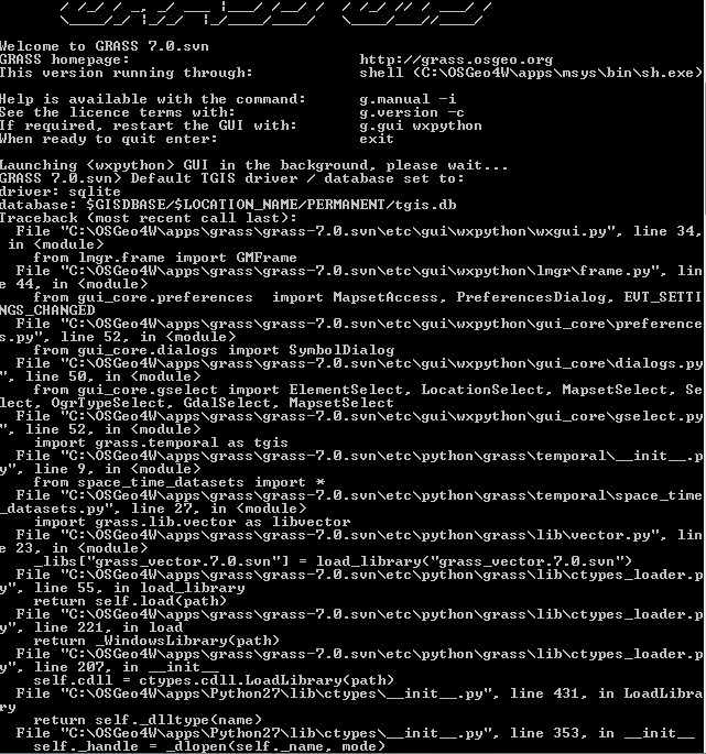

Hi
I just tried to load the latest version and got a different error. Print screen attached
Best regards
screen attached
it's related to
http://lists.osgeo.org/pipermail/grass-dev/2012-October/060217.html
https://trac.osgeo.org/osgeo4w/ticket/305
best regards
Helmut
