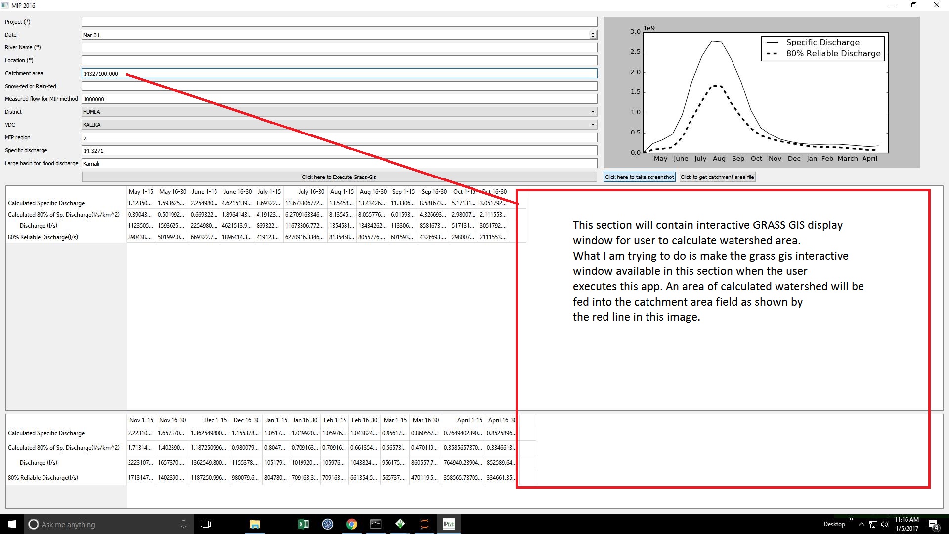

On Thu, Jan 5, 2017 at 1:43 AM, Ang Sherpa <angsherpa232@gmail.com> wrote:
Thanks Martin for your response. Actually, cairo is good idea, however, what
I am trying to do is building an app. I have already invested lots of my
time developing interactive gui as shown in the attached screenshot. My
ultimate plan with grass gis is mentioned in the red-box in attached
screenshot.
I have a feeling that this process should work as expected.
1. Isn't there any way to make grass gis run in background or some kind of
temporary directory?
2. Is there any way that can run the GRASS GIS COMMAND SHELL without running
the wxgui?
2. Interestingly in d.mon document it says that "The desired monitor should
be started once and need not be restarted unless it is stopped for some
reason. A monitor may continue to run for any length of time, even when no
GRASS session is being run." But don't know what these exactly means if
working through standalone script.
I will be really grateful if you could show me some way to make this work.
Will be looking forward to hearing from you.

This initiates the grass gis and will be running background.
subprocess.Popen([‘cmd’,‘/K’,‘grass72 -text’],cwd=gisbase)
However, the d.mon does not open even after executing
from grass.script.setup import set_gui_path
set_gui_path()
Am I still missing something?

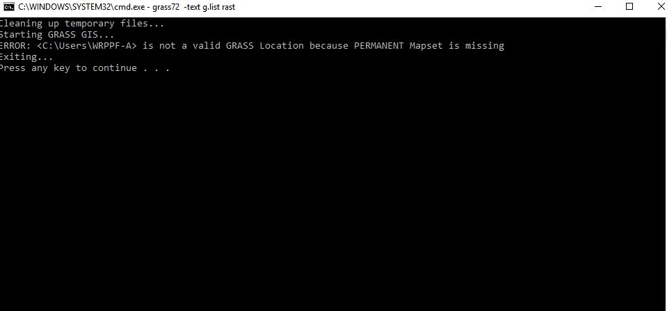

I also tried running by directly injecting ‘d.mon start=wx1’ command to the subprocess itself. With this approach I got an error as stated in ##ERROR (as shown in attachement_2)
subprocess.Popen([‘cmd’,‘/K’,‘grass72 -text’,‘d.mon start=wx1’],cwd=gisbase)
##ERROR: Cleaning up temporary files…
Starting GRASS GIS…
ERROR: <C:\Users\WRPPF-A> is not a valid GRASS Location because PERMANENT Mapset is missing
Exiting…
Press any key to continue . . .

I also tried running by directly injecting 'd.mon start=wx1' command to
subprocess.Popen(['cmd','/K','grass72 -text','*d.mon start=wx1*
'],cwd=gisbase)
This is missing --exec parameters and is likely not appropriate together
with grass.script.setup.init().
