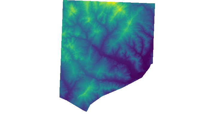

I just re-imported and re-projected the map and it does fit much better than
the first couple of times I did this. Very strange. Adding that one portion
to the basin map (attached) the minor breaks are not visible.
Thanks for prompting me to try again. Now on to the other missing pieces.
