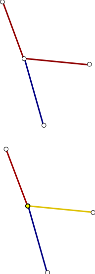

Hi,
as an explanation I draw a little picture...
I like to have each line extra to have a common node on each crossing. I
would to have that in order to try handling tree structures and some
analysis in a database.
Thanks,
achim

Sorry, not very clear... They are "snapped"!
I wanted to show that I have
1) two lines (two cats) with no common nodes on the network
2) I want the longer to be broken on the node of the longer one in order
to have a common node (and three lines with three cats)
achim

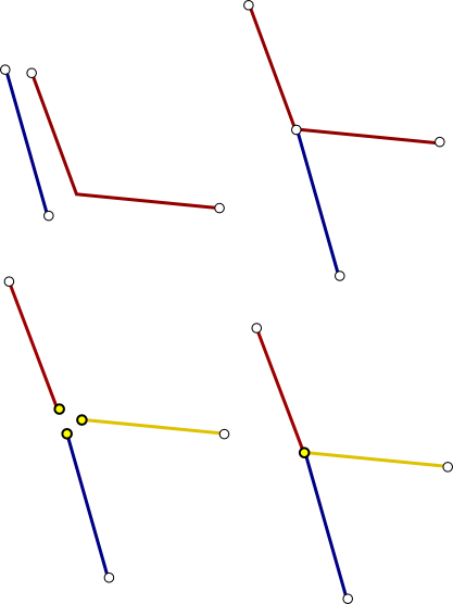

Sorry, I still don't understand: what do you mean by "the node of the longer one" ? If each line is a straight line, then you have two nodes, one at each end. So, do you mean that you want to break the longer line, thus creating two new nodes, representing the new end points of the two parts and then snap these two nodes back together again and snap a third node (from the other line) to that same place ?
If that is what you want to do, you can use the 'connect' tool in v.edit (see "Connect lines" in the man page).
If you want to break you line at the coordinates of a specific node, you can do it this way:
v.edit tool=break cat=CatOfTheLineToBreak coords=CoordinatesOfYourNode thresh=
v.edit tool=snap cat=CatOfTheBrokenLine,CatOfOtherLine thresh
You can get the coordinates of your nodes with v.to.db.
Hope this helps,
Moritz
thresh=
Thats what I was looking for. Thank you very much, Moritz! I didn't
recognized the break tool...
Sorry for complicated problem description. I am still a little confused
why v.net produces such lines that no new (poly)lines begin on each node
(picture).
So I write a script with "v.edit tool=break" that does that for me.
(And thank you very much for tip how to insert a new line on a network.
I will have a closer look at the significant awk!)
achim

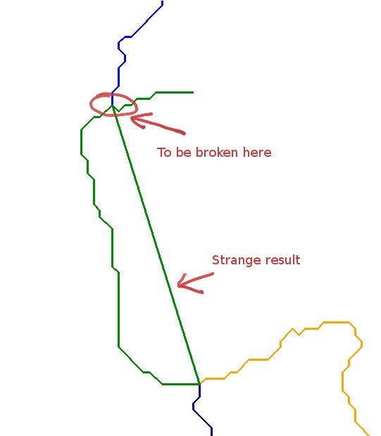

Hello,
there is another "strange result" I don't understand. I attach a picture
to show, what I mean.
I guess it has to do with producing new start- and end-points and so a
new line is born?
Anyone an idea how to avoid this?

I now doing this one by one. ...not elegant but it works. Just have to
wait...
Achim

new line is born?
I try to break a couple of lines on specified points (nodes in a network
to get separated lines).
I do this with for one example-point successfully:
v.edit map=laflo_break@achim layer=1 type=line tool=break ids=0-9999999
thresh=-1,0.000001,0.000001 coords=32.6958333333333,8.67083333333333
but doing this with a list of more than 6 coors or having the same coor
twice in the list, I get the "Attempt to delete dead feature"-error.
Is there a limiting number of coords for v.edit or is it something else?
What does grass try when it "Attempt to delete dead feature"
wait...
