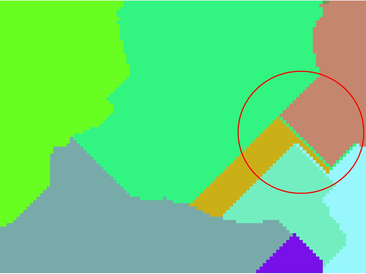

with r.watershed I get strange basin boundaries for some areas und I'm not able
to give account of it. Attached you can find that part of the basin map which
looks curiously. I means the sharp-edged regions...
Whats the reason?
Basis is an Arc Info .adf raster file for DEM data.
Thanks a lot for any advice.
Christian

This is most probably a flat area (no slope). Flow direction, flow accumulation, stream segments and basins can not reasonably be calculated for flat areas, these are regarded as missing information and some assumption has been made by the algorithm.
What could help is to use a raster DEM as input that is *not* filled, some would say not hydrologically correct, but r.watershed works better with the raw, not filled DEM.
What could also help, if this does not work or it really is a flat area, is r.watershed of grass7 with multiple flow direction. Note that the result may look nicer, but it still holds true that drainage direction (and therefore all other output) has to be estimated for flat areas. The A * Search of r.watershed is doing a pretty good job, and multiple flow accumulation can improve it a bit more, within limits.
I think Arc Info wants a depressionless, filled, hydrologically correct DEM. r.watershed does explicitely not want such a DEM, it wants a raw DEM with depressions, not filled, and not hydrologically correct.
I hope that helps,
Markus M
Could be an indication of too small a threshold. Or perhaps a faulty esri dem.
Mark

IMO the esri term of a filled DEM being "hydrologically correct" is a misnomer.
Natural terrain has real depressions that impact surface water flow. Big depressional wetlands can retain water and release via groundwater or evapotranspiration.
I like how r.watershed acomodates known depressions and handles the flow as interception. Also, then one can use other tools to find problematic areas in a raw DEM. I modeled an internally drained basin using known depressions in GRASS, and it worked fantastic.
One problematic example for esri is modeling an internally drained or sink-watershed. These have no surface water outlet. If one filled it to get flow out of a 9 sq. mile watershed, the esri analyses are then meaningless. Which is one reason why filling a dem just to get an esri module to work and calling the DEM "hydrologically correct" is a misnomer an a limitation.
Mark
