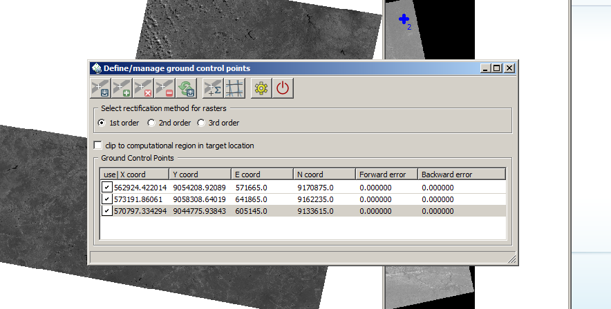

I’m using GRASS GIS 6.4.0 (stable version) in Windows (because my Univ made a few addaptations and modules to be used in my final project) but I’m having some difficulties in using Georectify tool.
After I select 3 points, I press Recalculate RMS Error (and I get the image that I have attached to the email). THis is impossible to have 0,0 as error (in this case). and I got:
(in this case).
No, because the RMS errors will always be zero if the number of points
is equal to the minimum number of points required for the selected
order, here 3 points for first order.
