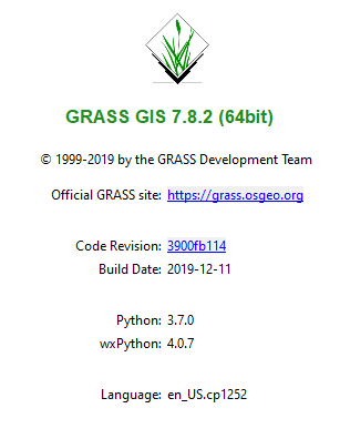

Thanks Markus,
It’s 7.8.2
g.version -rge
version=7.8.2
date=2019
revision=3900fb114
build_date=2019-12-11
build_platform=x86_64-w64-mingw32
build_off_t_size=8
libgis_revision=00000
libgis_date=“?”
proj=6.2.1
gdal=3.0.2
geos=3.8.0
sqlite=3.29.0
I did see your email recently about 7.8.7…
I could just try version 8?

Hi Vishal,
On Wed, Feb 23, 2022 at 9:04 PM Vishal Mehta <vishalm1975@gmail.com> wrote:
Thanks Markus,
It's 7.8.2
g.version -rge
version=7.8.2
date=2019
.. your installation is a few years old - please consider updating to
7.8.6 or even 8.0.x.
I did see your email recently about 7.8.7..
Sure, that would be best.
