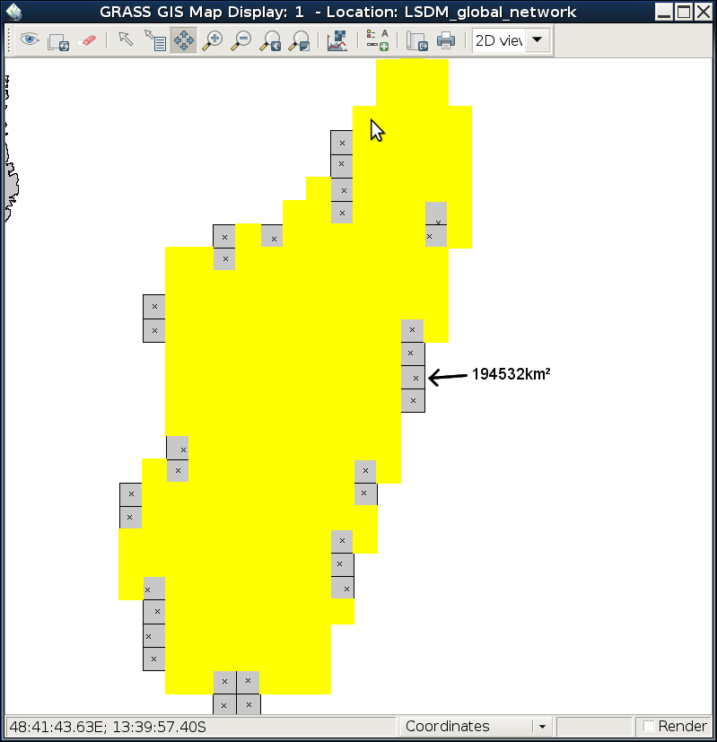

Hi,
I am using
v.to.db map=af_grid option=area columns=area type=centroid units=kilometers
(in GRASS65 opensuse 11.1 64)
to calculate the area size. Some of the areas are very wrong. Its a grid
in lat-lon, where areas should be nearly equal in size.
Is this a known bug? I don't guess so.
Do I something wrong?
Thanks,
Achim

Hi Markus,
its the same with hectares; kilometers writes out the result in
square-kilometers.
Achim

Achim, how was the grid generated? Could you put some fo the results here?
Pablo.

I made the grid with:
v.mkgrid --overwrite map=$1_grid_all grid="$north_south,$east_west"
position=coor coor="$southwest_corner" box="0:30,0:30"
echo "
## shrink grid to land-surface"
sqlite3 $2 "drop table $1_grid_patched"
v.overlay --o ainput=$1_grid_all binput=$1_area output=$1_grid_patched
v.db.addcol map=$1_grid_patched columns="keep INT"
sqlite3 $2 "UPDATE $1_grid_patched SET keep=1 WHERE (NOT b_cat IS NULL
OR ((a_row*1000)+a_col) IN (SELECT (a_row*1000)+a_col FROM
$1_grid_patched WHERE NOT b_cat IS NULL))"
v.extract input=$1_grid_patched output=$1_grid_extracted where="keep=1"
--overwrite
v.db.addcol map=$1_grid_extracted columns="dissolve INT"
sqlite3 $2 "UPDATE $1_grid_extracted SET dissolve=((a_row*1000)+a_col)"
v.dissolve --overwrite input=$1_grid_extracted output=$1_grid
column=dissolve layer=1
sh renew_cats.sh $1_grid 2 centroid
db.droptable -f table=$1_grid
v.db.connect -d map=$1_grid
v.db.addtable map=$1_grid
In the picture:
yellow grids seem ok (301.444-279.003 km²)
one is 194.532
the rest is 2.545.231-11.559.210
Achim

I think "v.dissolve" corrupted it.
I solved it by making a raster map and then a vector map again.
Thanks, Markus and Pablo,
Achim
