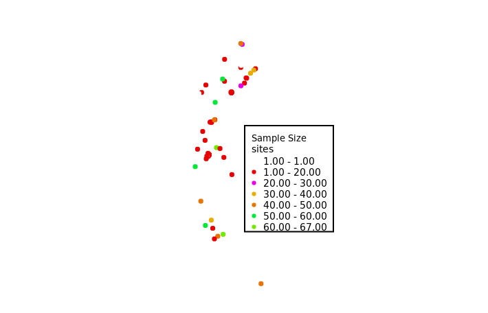

   The d.vect.thematic manual page tells us that there needs to be one more
color specified than breaks. Should this color be the first or last in the
list? And, if it does not represent a class between breaks does it matter
what this extra color is?
   This is the command I used; suggestions for fine-tuning it are welcome:
d.vect.thematic -l map=sites column=howmany breaks=0,1,20,30,40,50,60 \
colors=00:00:00,231:00:00,231:00:231,231:173:00,231:115:00,00:231:57, \
115:231:00,255:255:255 boundary_color=none icon=basic/octagon size=7
   The legend has an extra line with the map name and a blank row for 1.00
1.00. How can I remove the 'sites' string, change the range output to be
integers rather than floats, and remove the 1.00 1.00 row as it's duplicated
by the 1.00 20.00 row just beneath it.
   I tried some d.legend.vect options but they made no difference in the
results.
   The map and legend are attached.
duplicated by the 1.00 20.00 row just beneath it.
   By trial-and-error I created the results I want. Now I need to learn how
to use ps.map to apply the d.vect.thematic and d.legend.vect to the script.
I'll start a new thread on that subject.

   1.) I could not make the desired changes in the maps produced by
d.vect.thematic or in the legend produced by d.legend so I saved the
d.legend output to a .csv file and edited that to remove the redundant first
row and remove the decimals from the ranges. I've nothing to suggest for
changes to the manual pages (other than some typo corrections, but they're
very minor.
