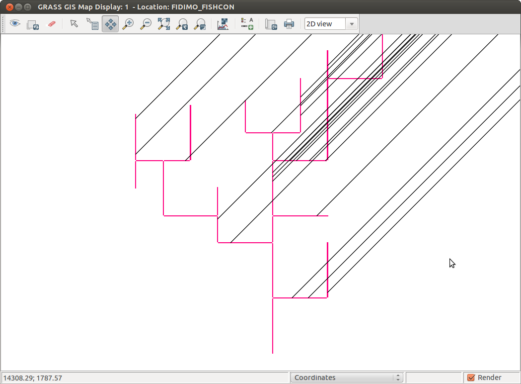

I am running the latest revision of GRASS7 (rev 57514). When I try to create
random vector points based on a raster map input using the tool r.random I get something
very weird but definitely no vector points. I seems that the points are somehow lines.
Here what I am doing (tested with absolute n and with %n):
r.random input=river_raster n=2 vector_output=source_points_test
The output is attached as a screenshot (red=raster input, black=should be vector points)
Is there anything I a doing wrong or is this a bug in r.random?
Maybe someone can test that. Thank you!

Can you check with v.info if there is anything else but points in the
vector source_points_test?
I could not reproduce this with nc_spm data using a stream network
derived from elev_lid792_1m.
Markus M
Hi Johannes,
I seem to have encountered the same :
http://osgeo-org.1560.x6.nabble.com/Problem-displaying-imported-3D-points-shapefile-in-GRASS-7-td5076193.html
Grass 7: version 57592
Richard

That problem seems to be solved. :slight_smile:
