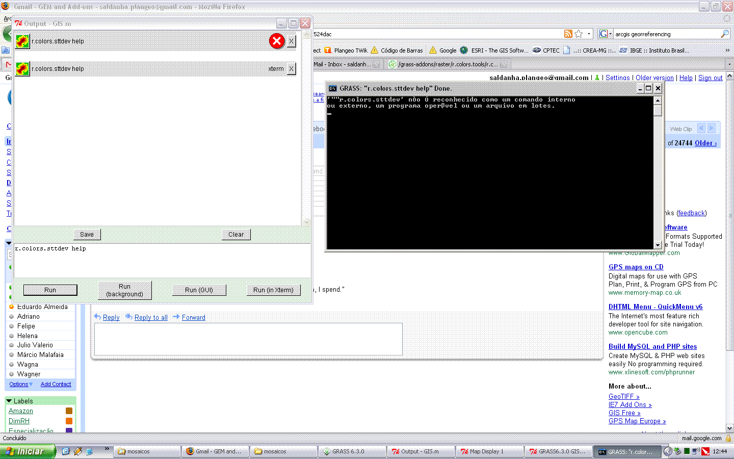

The screen, attached.

On Dienstag, 12. August 2008 17:26:37 you wrote:
Ok, I put the file (r.colors.sttdev) on C:\GRASS\scripts.
On the output windowm, if I enter with r.colors.sttdev and Run, seems GRASS
recognize the command. But how in the syntax to inform the input and other
parametres?
Can I found this in the code?
yes, but easier just do:
sh r.colors.stddev --help
or look at line 16-35 there you finde 'input', 'key: b' and 'key:z' and the
corresponding description below it. But just the input is required hence
sh r.colors.stddev input=YOUR_RASTER
should work.
On Tue, Aug 12, 2008 at 12:34 PM, Raphael Saldanha <
saldanha.plangeo@gmail.com> wrote:
> No response...
> On Tue, Aug 12, 2008 at 12:32 PM, Nikos Alexandris <
> nikos.alexandris@felis.uni-freiburg.de> wrote:
>> > GRASS recognize the command. But how in the syntax to inform the input
>> > and other parametres?
>> Try the command "r.colors.sttdev help"
> Atenciosamente,
> Raphael Saldanha
> Joan Crawford - "I, Joan Crawford, I believe in the dollar. Everything I
> earn, I spend."

Hi,
Nikos:
> on a linux-box it's pretty easy because "r.colors.sttdev" is a shell
> script. I assume in this case it's the same on a winbox (not sure
> though).
I too have little idea about ms-windows + Msys.
> Copy it [1], save it as r.colors.sttdev.sh
> Sorry, I think the suffix ".sh" is not required. Just save as it is
> (r.colors.sttdev). Maybe you have to give proper file permissions.
> under /Your_GRASS_installation_directory/scripts (I don't know where
> GRASS is saved by default on a winbox) and execute from within the
> GRASS shell as you do with any other module.
> [1]
http://trac.osgeo.org/grass/browser/grass-addons/raster/r.colors.tools/r.colors.stddev
You need to go to the end of that webpage and click one of
"Download in other formats:
    * Plain Text
    * Original Format"
i.e. get it *without* line numbers or any other cruft, those are just
for presentation on the web page.
I find the script to be very useful, I hope you do as well.
Hamish

I can get the help with:
sh C:/GRASS/scripts/r.colors.stddev --help
And run the script with:
sh C:/GRASS/scripts/r.colors.stddev input=HRC_20080528_151_B_124@PERMANENT
Running the script, I get a blank cmd, no percentages or anything, with the name “C:\GRASS\msys\sh.exe”
But works!!!
Thanks for the help!
But, the script makes a colored output, and I want a grayscale…
So, reading the code, I found this:
if [ $GIS_FLAG_Z -eq 0 ] ; then
MEAN_MINUS_2STDEV=echo "$mean $stddev" | awk '{print $1 - 2*$2}'
MEAN_PLUS_2STDEV=echo "$mean $stddev" | awk '{print $1 + 2*$2}'
if [ $GIS_FLAG_B -eq 0 ] ; then
smooth free floating blue/white/red
r.colors “$GIS_OPT_INPUT” color=rules << EOF
0% blue
$MEAN_MINUS_2STDEV blue
$mean white
$MEAN_PLUS_2STDEV red
100% red
The, I change to:
0% black
$MEAN_MINUS_2STDEV black
$mean grey
$MEAN_PLUS_2STDEV white
100% white
But the output turns the colors to a light grey filter or something… how can I maintain the black pure black?
