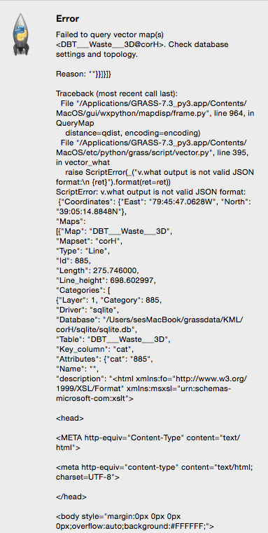

I have imported a kml file that contains contours of a feature of interest. Functionally an x,y,z data set. It displays correctly in GRASS. When queried to determine the value of z, the attached error is given that indicates a lack of conformance with JSON formatting. The values of z are given for the feature in the error message but additional processing such as v.to.rast does not work. GRASS is able to label the contours correctly. Using the attribute table manager is not much help - it produces an error that indicates ‘Inconsistent number of columns in table’.
I see that there is a bug report (3133) that reflects the same problem but has been fixed in 7.0.5 - I’m getting the ‘same’ error in 7.3.svn. (on OS X 10.10.5)
The error message is too long to fit on the monitor - and is not scrollable, so the full content is not visible.
Any assistance or advice much appreciated.
Stu

please post (or attach) the text outputs of v.what with -j flag and v.db.select, which are the backend commands behind the GUI dialogs. That helps us to analyze it.

Looking at the attachment, the problem is definitely in multiline
strings in your 'description' column. I suggest to create a ticket for
this. For now, you might want to consider deleting that column if it
is not needed, to be able to use the vector.
Anna
Anna
Deleting the description column eliminated the error and the file performs as expected
thanks!

However, the v.what -j command produces a similar result to the one above:
(Sun Feb 12 17:29:12 2017)
v.what -j map=DESIGN_MAJOR_CONTOURS@corH coordinates=-79.7618228288,
39.0853199854
{"Coordinates": {"East": "79:45:42.562184W", "North": "39:05:07.151947N"},
"Maps":
[{"Map": "DESIGN_MAJOR_CONTOURS",
"Mapset": "corH"}
(Sun Feb 12 17:29:12 2017) Command finished (0 sec)
and the v.db.select output is much shorter:
(Sun Feb 12 17:35:44 2017)
v.db.select --overwrite map=DESIGN_MAJOR_CONTOURS@corH
file=/Users/sesMacBook/Baker/CorridorH/WasteDisposal/vdbselect2
(Sun Feb 12 17:35:44 2017) Command finished (0 sec)
produces:
cat|Name|description|timestamp|begin|end|altitudeMode|tessellate|extrude|visibility|drawOrder|icon
1|Style2|||||absolute|-1|-1|-1||
I can send you the two kml files if that would be helpful.
thx
Stu
On Feb 12, 2017, at 3:44 PM, Anna Petrášová <kratochanna@gmail.com> wrote:
Hi,
On Sun, Feb 12, 2017 at 10:36 AM, Stuart Edwards <sedwards2@cinci.rr.com>
wrote:
Hi -
that indicates 'Inconsistent number of columns in table'.
has been fixed in 7.0.5 - I'm getting the 'same' error in 7.3.svn. (on OS X
10.10.5)
Anna
Stu
<Screen Shot 2017-02-12 at 10.29.33 AM.png>

I now have a working vector file that displays correctly and can be queried with normal results. However after much trial and error I am still unable to access the elevation data in other modules (e.g. v.to.rast). There is always a requirement to specify the attribute - and as you can see, the geotmetric data are not attributes and do not show up in the menu of attributes. Here's the output from a query that may help visualize the problem:
east, north: -79.7630759471, 39.0874586371
DBT@corH:
  Type: Line
  Length: 275.746
  Line_height: 698.602997
  Layer: 1
  Category: 885
  Driver: sqlite
  Database: /Users/sesMacBook/grassdata/KML/corH/sqlite/sqlite.db
  Table: DBT
  Key_column: cat
  Attributes:
    cat: 885
    cat_: 885
    tessellate: -1
    extrude: -1
    visibility: -1
What I need is the Line_height value, which is not an 'attribute' - neither is it 'z'
I tried exporting the file as a shape file and reimporting it - same result. Then as a GRASS ascii - no file created - and ran out of ideas. Is there a way to add Line_height as an attribute?
Any help appreciated...
Stu

I would try v.to.db with option start, then v.to.3d
Hope that helps
It would probably be nice, and IMHO not too complicated, to add line height as an option to v.to.db. Stuart, I invite you to post an enhancement request on the trac [1] for that.
Moritz

… that would be very cool. Done.
