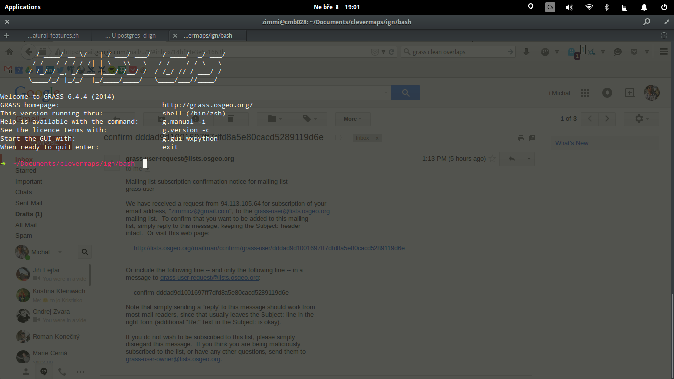

Hi, when I try to run grass (both 6.4 and 7.0) with -text interface, it immediately switches back to shell. I haven’t found anything related to this issue, can anyone help me? Thanks
(attachments)
Screenshot from 2015-03-08 19:01:11.png
immediately switches back to shell. I haven't found anything related to

No I can’t. But it seems grass is running, because when i try to run it again in the same location, it says concurrent use is not allowed

On Mon, Mar 9, 2015 at 2:43 PM, Micha Silver <micha@arava.co.il> wrote:
On 03/09/2015 03:32 PM, Michal Zimmermann wrote:
Hi,
when run with the command you sent, it gives the following output:
Cleaning up temporary files …
Starting GRASS …
/usr/lib/grass64/etc/Init.sh: 409: /usr/lib/grass64/etc/Init.sh: /etc/clean_temp: not found
/usr/lib/grass64/etc/Init.sh: 580: /usr/lib/grass64/etc/Init.sh: /etc/set_data: not found
So something with the PATH is definitely not getting setup right.
What are the contents of /usr/bin/grass64?
I installed 6.4 from the official ubuntu repo and 7.0 comes from ubuntugis repo. init.sh is completely missing for v7.0.
Yes, grass70 starts with a different script altogether (python)

On Mon, Mar 9, 2015 at 2:29 PM, Micha Silver <micha@arava.co.il> wrote:
Hi Michal
(keeping this on the list…)
On 03/09/2015 02:46 PM, Michal Zimmermann wrote:
That works. I always thught you could run grass from interactive shell, was I wrong?
You can definitely run GRASS from the shell, in text mode only. It’s been like that for a few years now - since about 1983 :wink:
How did you install? Maybe try running the Init.sh (/usr/lib/grass64/etc/Init.sh) to follow error messages.
Also what shell are you running? I seem to recall seeing in the original post zsh? Wonder if that could be the problem?

On Sun, Mar 8, 2015 at 10:21 PM, Micha Silver <micha@arava.co.il> wrote:
Weird
Well, starting GRASS in text mode is really nothing more than setting some environment variables. I’d suggest you try to setup the environment manually, then try to run some modules.
Here’s the explanation how to do this:
http://grasswiki.osgeo.org/wiki/Working_with_GRASS_without_starting_it_explicitly#Bash_examples_.28GNU.2FLinux.29
On 03/08/2015 11:03 PM, Michal Zimmermann wrote:

Od:Micha Silver
Odesláno:‎8. ‎3. ‎2015 22:02
Komu:Michal Zimmermann; GRASS user list
Předmět:Re: [GRASS-user] GRASS jumps to shell immediately after start
Try to delete the file “.gislock” in the MAPSET directory that you are trying to work with, then start grass64.

On Sun, Mar 8, 2015 at 8:11 PM, Micha Silver <micha@arava.co.il> wrote:
I guess you mean that the GRASS environment is not being setup? Can you run i.e. g.version ?

That looks correct. I’m out of ideas…
On 03/09/2015 03:53 PM, Michal Zimmermann wrote:
trap “echo ‘User break!’ ; exit” 2 3 9 15
Set the GISBASE variable
GISBASE=/usr/lib/grass64
export GISBASE
exec “$GISBASE/etc/Init.sh” “$@”
Hi,
Starting GRASS …
