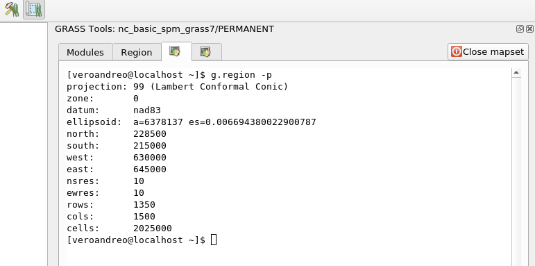

Hello Valter,
It works here with a single click. It just opens a new tab there with a terminal (bash shell in my case). You first need to open a location and mapset with the GRASS Plugin to get it activated, but I think you did, right?
What operative system do you use?

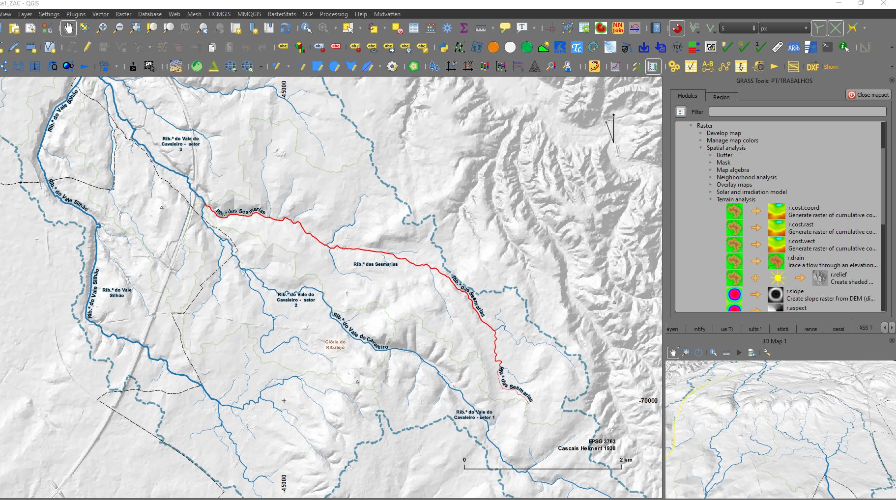

1) Yes, yes. Because of the activation i can compute the GRASS modules from this console:

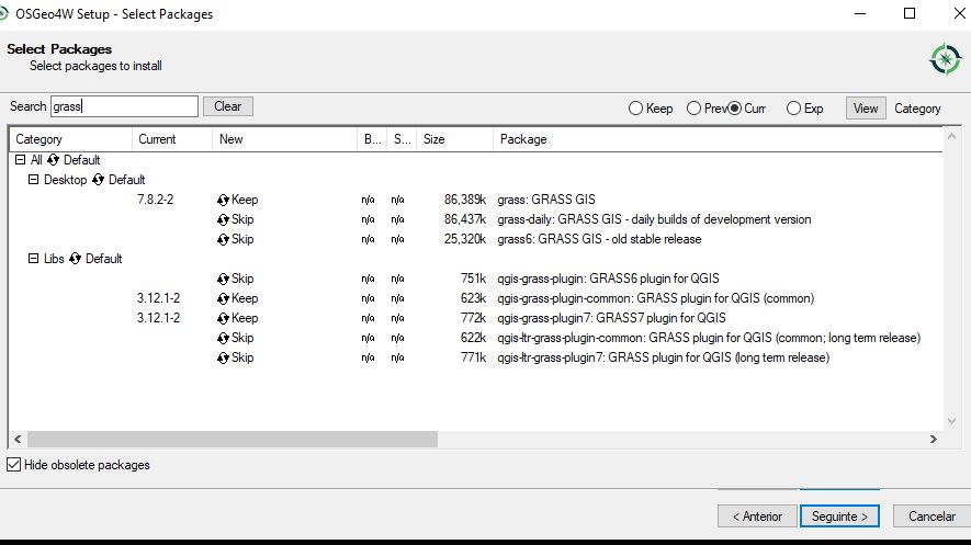

3) GRASS plugin plus QGIS installed with OSGeo4W installer

Another information: the GRASS installation was made with the options marked with “Keep” - see the image bellow:

Dear Valter
AFAIK, the GRASS shell in QGIS plugin doesnt work in Windows. Somebody please correct me, if I am wrong. Also r.mask doesn’t work if you use grass7 plugin in QGIS.
As you are using Windows 10, best solution to get the complete command line functionalities (as in linux) of GRASS GIS is to follow “Linux Bash Shell on Windows 10” (https://itsfoss.com/install-bash-on-windows/), which is in-built app with windows 10, you have the option to install Ubuntu, Suse linux etc.
Then you can install GRASS GIS and QGIS in the Linux environment in windows 10 and then this plugin works well. You may need a X server installed to make gui’s work in the Linux environment like xming (https://sourceforge.net/projects/xming/ )

Hello Valter,
best,
Vero
