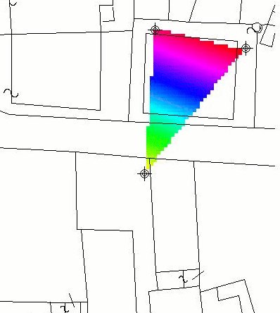

I have tried to interpolate the tree points of a 3d triangle...
using v.surf.rst and smoothing=0 and tension=1 (for creating a perfect
plane) but the results is not so fine (please see the small attached
file, I apologize for this image with the users of the mailing list)
I know I can use r.plane for creating a single plane but I should know
the azimut and deep of the plane... is there a way to obtain this
information for a 3d triangle??? (not in a manual way obviously)

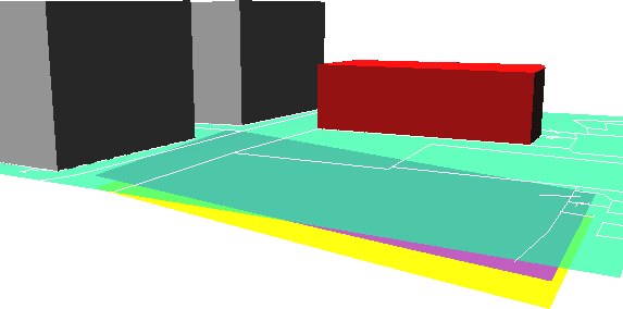

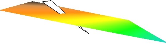

Dear Thomas, dear all...
my application is, at the moment, really simple...
I have the stratigraphy of tree points very near each other...
I was able to note the same stratigraphic sequence in the tree points,
but at different deeps....
My needs were to rebuild the bedding of the bottom and of the top of
some geologic layers....
in this way I can estimate the deep of these layer in different points
from the tree already sampled...
this is interesting for geothecnical reasons... because the thickness of
the layers is important for the calculation regarding the basement of
tree building
I have used the modified version of v.surf.nnbathy to find the plane
passing through tree 3d point (I had a vector 3d point map and I have
converted it into a simple raster map)
in this way I have obtained a raster map representing a 3d triangular
plane (see fig1.jpg)
using r.slope.aspect I have been able to obtain deep and direction of
the plane
then using r.plane I have been able to create a plane passing through
the tree points and extending outside of them (see fig2.jpg)
I hope this help to understand!!!
best regards
Ivan
