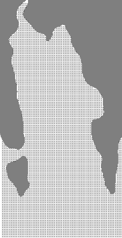

I make my grids in octave/matlab (command: griddata) then bring them into grass. Attached is an example. If you have any questions shoot me an e-mail.

Hi Nick Jachowski,
Can you tell me how you are making grid in matlab/Octave. And how you are exporting to Grass as i want to make triangular irregular network(TIN) for raster orthophoto on 1:5000 scale.
