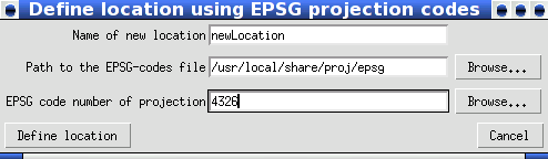

You must begin again. Start "grass", and click "EPSG Codes". In the
next window, enter the code 4326, which is the correct value to use
geographical coordinates. Import your JPG image in this location.
(see images attached)
