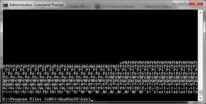

Hi Hamish
Thank you for your hints, however I didn’t managed to solve the problem.
I installed NetPBM tools has you suggested, however I still get hundreds of .ppm files instead of one big high resolution file like I need.
I then tried Windows command prompt with these sentences:
C:\Program Files (x86)\GnuWin32\bin>pnmcat -lr C:\Users\Andre\Pictures\aaa\E-W-45_1_1.ppm
C:\Program Files (x86)\GnuWin32\bin>pnmcat -tb C:\Users\Andre\Pictures\aaa\E-W-45_1_1.ppm
In both cases all I get has output can be seen in attachment, but no assembled image is produced.
What am I doing wrong? Is there an alternative method to assemble .ppm tiles?
Thank for your time
Best wishes
André Mano
