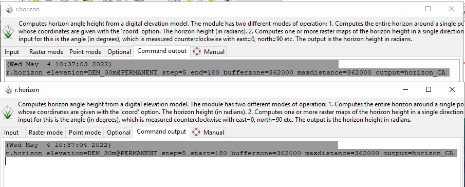

I am trying to generate total radiation grids using r.sun, but when I use the outputs of r.horizon with r.sun, no output file is created. I ran r.horizon for all angles between 0 and 360 with an angle step of 5. However, I ran the angles in separate tool windows. I used the same base name for all runs of r.horizon, but these files don’t seem to work together in r.sun.

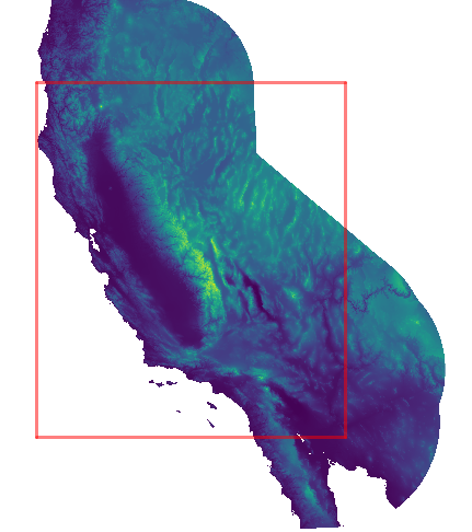

  1. Load in the 30-m DEM and set computation extent to the boundary of California.
  2. Use multiple windows of r.horizon to generate 72 horizon rasters.

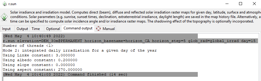

    1. Use r.sun to generate global irradiance grid.
  3. There is no output file created.

I don’t see anything wrong here, so my suggestion would be to replicate your workflow on the NC sample dataset and see if that works properly. If not, then it would be easier for us to figure out what’s wrong. If the workflow works on the NC dataset, but not on CA, the problem could be perhaps that the r.sun process crashes due to insufficient memory or a bug.
