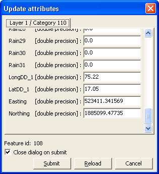

> I am developer not user I would like to edit the window like-
> Inline image 2
> And in this case want to shift the point with catagory 110 by changing latDD_1, longDD_1 as user specify the new position. I am unable to do this because I could’t find the source code relating to “Update Attribute” Please give me a technical reference.

Dear All,
Inline image 2
And in this case want to shift the point with catagory 110 by changing latDD_1, longDD_1 as user specify the new position. I am unable to do this because I could’t find the source code relating to “Update Attribute”. Any one please give me a technical reference.
Thanks & Regards,
Swapan

On Thu, Jul 19, 2012 at 1:11 PM, SWAPAN GHOSH <swap.ghsh@gmail.com> wrote:
Dear All,
You can find it in ./gui/wxpython/dbmgr/dialogs.py as class DisplayAttributesDialog
Anna
