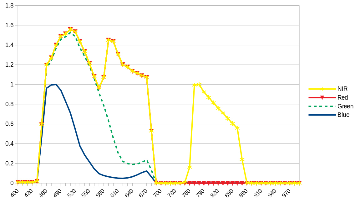

I was able to compile a new satellite sensor (from Planet labs) in the
i.atcorr module. I've tried several different things but I keep getting all
nulls for the red, blue, and green bands while getting good values for the
NIR. I know the region is correct, plus I get values for atmospherically
correcting the NIR band so I cannot think of anything else that may be
wrong! I've attached the file I generated with the create_iwave script. I
also followed the how to guide within the i.atcorr module, and tried this on
grass 7.5 and 7.4
Any help is greatly appreciated,
Gwen

I've taken your (offlist) CSV files and made a plot (attached).
To me the curves look too much correlated in order to produce anything
reasonable with i.atcorr (6S).
Have these filter functions been officially published anywhere?
