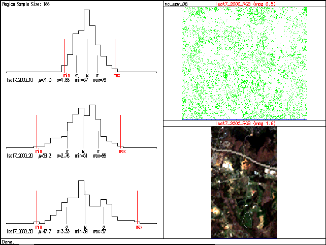

I’ve been trying to do a supervised classification from landsat8 imagery using i.class and then i.maxlik, but I’m getting an error when running i.maxlik saying it can’t read the signature file.
I tested my procedure on the NC sample dataset and I’m getting the same error, I’m using Grass 6.4.2 on Debian Wheezy, installed from the debian repo. Here’s the command set:
#Display RGB enhanced map
i.landsat.rgb blue=lsat7_2000_10 green=lsat7_2000_20 red=lsat7_2000_30
d.rgb blue=lsat7_2000_10 green=lsat7_2000_20 red=lsat7_2000_30
#“Real color” map
r.composite red=lsat7_2000_30 green=lsat7_2000_20 blue=lsat7_2000_10 output=lsat7_2000_RGB
#Group images to process
i.group group=lsat7_2000_RGB subgroup=lsat7_2000_RGB input=lsat7_2000_10,lsat7_2000_20,lsat7_2000_30
#Unsupervised classification
i.cluster group=lsat7_2000_RGB subgroup=lsat7_2000_RGB sigfile=clustlsat7 classes=20 report=rep_clust_lsat7.txt
i.maxlik group=lsat7_2000_RGB subgroup=lsat7_2000_RGB sigfile=clustlsat7 class=lsat7_classes reject=lsat7_classes_rej
#Supervised classification
i.class map=lsat7_2000_RGB group=lsat7_2000_RGB subgroup=lsat7_2000_RGB outsig=classlsat7
i.maxlik group=lsat7_2000_RGB subgroup=lsat7_2000_RGB sigfile=classlsat7 class=lsat7_class_sup
Here I get the error in which i.maxlik can’t read the signature file created by i.class (classlsat7) but read the one created by i.cluster flawlessly
This is what I’m selecting on the i.class monitor, I named it vegetation:
Imagen integrada 1
And the contents of the classlsat7 signature file are the following:
#vegetation
166
Am I doing something wrong or is it some kind of bug?

Hi Augusto,
In GRASS-6.4.3, i.class only works on 8bit images. Since the Landsat 8 products are
12bit data, proper signature files cannot be produced by i.class.
You could try rescaling data to 8bit and see if i.class and i.maxlik works.
Best
Venka
P.S. I hope i.class will be support 12, 16bit images in future.

Hello Nikos,
2013/11/27 Nikos Alexandris <nik@nikosalexandris.net>
Cesar Augusto Ramírez Franco wrote:
Hello everyone,
Hello,
Just to double-check: verify that your “classes” don’t overlay any NULL cells.
It might be completely irrelevant, I have, though, blurry memories of this
being a blocker actually (with i.smap at least).
​There are no NULL cells on my classes, neither on my Landsat 8 images or the Landsat 7 in the North Carolina dataset
#“Real color” map
(I have never tried to feed a group that uses a single composite. I’ll try it
out.)
The composite is for the supervised clasification, the group and subgroup are made with the 3 RGB bands (1,2,3 in Landsat7 or 2,3,4 in Landsat8)​
Does the unsupervised classification work? i.cluster requires at least two
input raster maps. And, honestly, I have never tried it the way you did, i.e.
by using a composite map. Also, r.composite will use by default “32 levels”
whicih means that you loose important info for the subsequent classification,
if I am not wrong.
​The supervised classification does work, i.cluster generates a signature file and i.maxlik success to create the classes raster map
outsig=classlsat7
flawlessly
[image: Imagen integrada 1]
Only on class? Can you try with more please?
Yes, the error I’m getting is only with the i.class module
I’m doing some tests creating a test vector​​ with my classes as areas, then converting it to raster with v.to.rast, and then using that raster to generate statistics for i.smap with i.gensigset
I don’t know if I’m not using the i.class module the right way or if it’s broken
#vegetation
166
Greets, Nikos
​Thank you very much​
César Augusto Ramírez Franco
Laboratorio de Sistemas Complejos Naturales
Escuela de Geociencias
Facultad de Ciencias
Universidad Nacional de Colombia - Sede Medellín
Teléfono: (57-4) 430 9369 - 301 389 5607

> > This is what I'm selecting on the i.class monitor, I named it
> > vegetation:
> > > vegetation:
My map looked similar.
