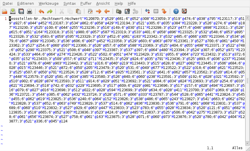

Hi Johannes,
i guess your csv file uses funny characters for spaces and new lines
and grass can not handle them.
I have attached a screenshot showing the file opened in vim using ubuntu linux.
Best regards
Soeren
