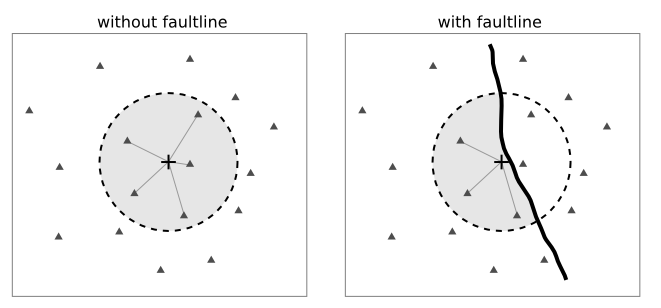

The attached picture is a sketch I made based on what I remember from
a conference, long time ago, about some software that did interpolate
with faultlines and how it worked.
Carlos
