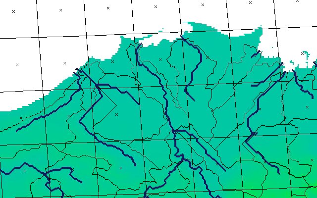

Hi Markus,
thanks for these fine answers.
I used the new r.watershed-version, which is very fast and can handle
massive gids like r.terraflow (in grass64)
Yes, r.waterflow produces very good results, including stream-segments.
But I would have to vary the threshold manually and many times to get
all basins.
I attach an example-jpg to illustrate my point of view...
achim
OK, I think I understand.
You could get the start points with r.mapcalc
r.mapcalc "start_points = if(!isnull(stream_segments) && drainage < 0, 1, null())"
convert the start points to vector
r.to.vect in=start_points out=start_points feature=point
get coordinates for each point with v.to.db map=start_points -p option=coor
ideally pipe the output of v.to.db to something that generates a script to call r.water.outlet with each set of coords, otherwise it's manual editing
