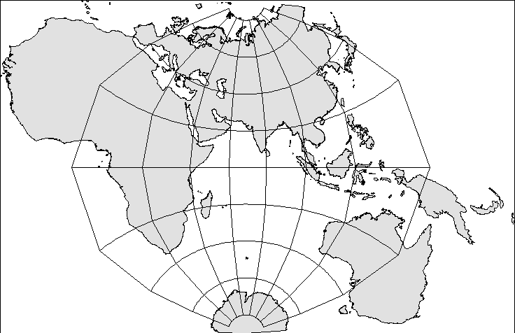

Transverse Mercator is just the Mercator math rotated by 90
degrees AFAIU. So along +lon_0 distortion is nil from north to
south pole, but if you go more than 90 degrees east or west
of +lon_0 it blows up. (see attached* for UTM zone 42, here
Western Africa becomes like Greenland does in the Mercator proj.
The Pacific Ocean explodes too, but it is harder to see due to
lack of land)

[*] 20deg reprojected grid lines are a bit ugly, apparently we
need to extend the v.mkgrid breaks= option to work on vertical
lines as well as the horizontal ones.
