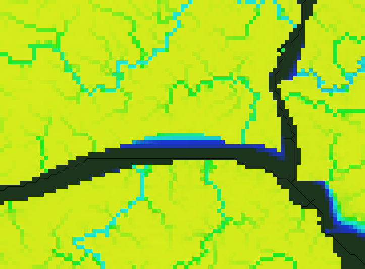

Dear friends,
I derived this accumulation map from 90m srtm data.
Across the river, the accumulation varies and the river line passes through the maximum of these values.
Typical Scenario:
On right bank Acc= 3
Near Right Bank Acc=100000
-.-.-.-.-.-.-.-.-.-.-.-.-|.-.-.-.-.-.-.-.–.-.-.-.-.-.-.-.-.- on river line Acc=500000 →
|______
Near left Bank Acc=300000
On left Bank Acc = 2
i.e. Just at the banks, accumulation values have big difference.
Whether this fact can be utilised to derive both banks of a river network.
(attachments)

You could try to calculate slope with the flow accumulation map and
then identify river banks as cells with high slope and low flow
accumulation.
Just an idea,
