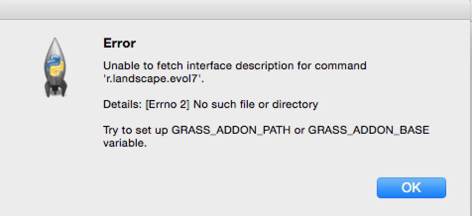

The script I am trying to add on is not available in the add-on repository as far as I know. I used BatChmod to make sure that I have the permissions of the (.py) script folder. Then I moved the script into the “scripts” folder located under (right click on the GRASS 7.0 app >Contents>MacOS). In the scripts folder, all scripts have black icons with the word ‘exec’ on the upper left corner. The script I dropped into the scripts folder did not have that, so I used:
chmod +x /Users/bulentarikan/Desktop/r.landscape.evol7.py
However, that did not change anything! The file is still not executable. So, my first question is, how can I make the script file an executable file?
In the Terminal, I call the script by typing its name. I get the error below:
Does this mean that I also need to have the executable file in /Users/bulentarikan/Library/GRASS/7.0/Modules?

there is an addon r.landscape.evol for grass 7, can’t you use that one?
Have you tried to run the module in command line with some parameters (not launching the dialog)? You can try r.landscape.evol7.py --help and you will see if it runs. I’ve seen this error before but I don’t really know where it comes from.
