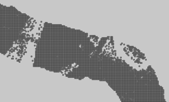

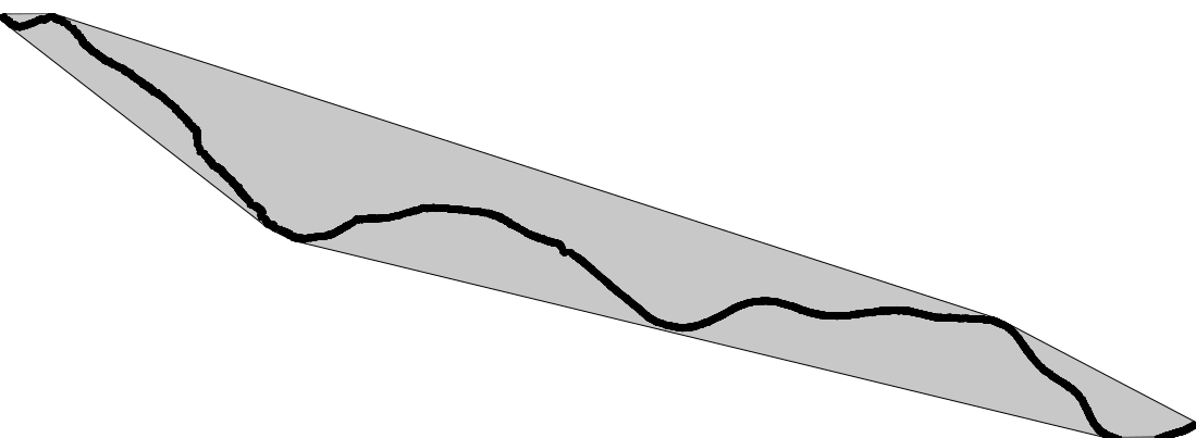

We have a linear feature of ~60km which is a future path of a road having ~400m in size and being quite curved.
I’d like to create a mask for raster operations that fits this shape.
Hull creates a convex shape which is hice but still have many “empty” space involved. This is sparse lidar data, anyway.
Is there a techique to create such a raster mask/map?
Pure rasterization won’t work since it has holes (see also vectorized coverage at 10m resolution, zoomed into a “hole”.
I’d need something like a “concave hull” function :slight_smile:

I realized that the addon is for vector, so I converted my raster (that's
what I have) to points but even when downsampled is was very slow, actually
(~480000 points), I was not able to wait for it.
So, I created a workaround for sparse huge point clouds loaded into a
raster map. The method is not exact, this is a kind of approximation (as
raster is, always).
We start from "startvocer", created with r.in.lidar in my case:
   Type of Map: raster Number of Categories: 0
   Data Type: FCELL
   Rows: *28222*
   Columns: * 79670 *
   Total Cells: *2248446740*
!kép.png|384x266
zoom:
!kép.png|357x211
final:
!kép.png|404x270!kép.png|464x196
The final vector map in my case is one vector area.... it could now be used
to set MASK for raster operations later on...
*PROCESS (resolution degradation and buffer size /100/ should be tailored
to application:*
g.region raster=startcover # original resolution is 1m
g.region res=10
r.resamp.stats --overwrite input=00001_rec4@kana output=00001_rec4_int
method=minimum
r.buffer --o input=00001_rec4_int output=lasmaskbuf distances=100
# let the "paint" flow to fill gaps and smooth edges
r.mapcalc --o
expression="lasmaskbuf2=if(isnull(lasmaskbuf),null(),1)" # make all
values 1 in the buffer to let r.to.vect create one area
r.to.vect -s --overwrite input=lasmaskbuf2 output=lasmaskbufvec
type=area # make vector of the buffer
v.generalize --overwrite input=lasmaskbufvec@kana type=area
output=lasmaskbufvecgeneralized method=sliding_averaging threshold=10000 #
make simpler
v.buffer --o input=lasmaskbufvecgeneralized@kana type=area output=final
distance=-100 # cut back
Best regards
Robert
