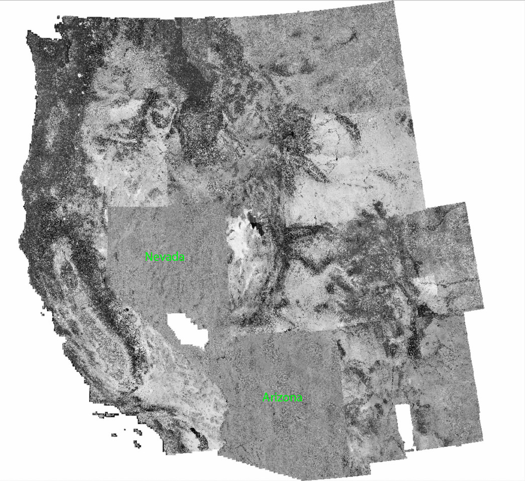

I am struggling to match histograms for various US states NAIP 1-meter aerial photography.
It appears that each state shown here has been equalized for each individual state except for Nevada and Arizona.
I have tried using r.rescale.eq with many different parameters but I cannot really get Nevada and Arizona to roughly match the intensities of the rest of the states. It is difficult to guess values that match because the images are quite large and when I attempt to use a thumbnail (say at 50m resolution), the parameters used for the 50m thumbnail don’t match when using the full resolution image.
Can anyone recommend how I might be able to get the histograms to match?

You can try the addon: i.histo.match. You can install it with g.extension.

imagery = raster. To be more precise, imagery is raster data in which pixel values are physical camera-like sensor values. But in terms of format they are identical, so no need to convert.
I tried installing the extension, but it fails with an SSL certificate error. I don’t see anyway to ignore or use a non-secure transfer.
I really cannot help you with that error. What you can do, however, is download the addon as a zip file from [1] and install directly from that zip with g.extension [...] url=/path/to/zipfile
