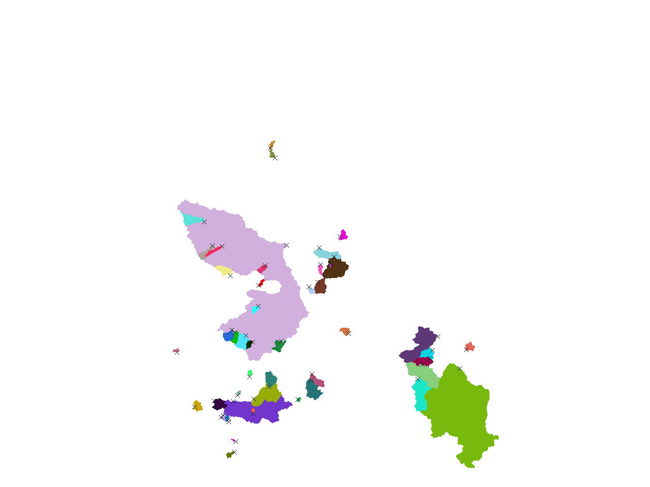

Remember that the working raster has an extent of 10000x10000 pixel. The single
calculated basins and their extents compared to entire drainage raster are very
small (see the attachment). While the duration of r.water.outlet is barely
acceptable, the merging step (regardless of the technique in A, B or C) takes
too long.
