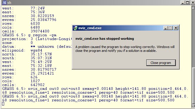

nviz_cmd.exe stops working in Grass6.5 and does not create the image - is this a known issue?
