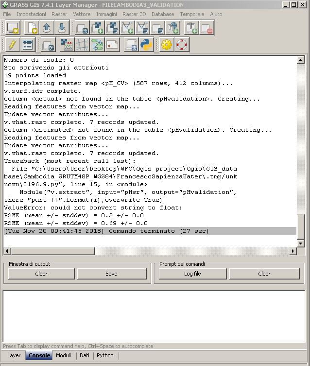

The script is working but at the third round of the loop i get a Value error (could not convert string to float). When i check the vector pHvalidattion, i see that for some reason i have created a blank value in the vector, that could not be used as a floating point number, of course… which is really unexpected because all the values from the input are simple numbers. (I’ve attached a screen of the vector with the blank value).
Another thing that bothers me is that the results are not printed the way i wanted, instead of the RSME and +/- st.dev, i get different results for RSME (one for each loop, i guess) +/- 0. Could be because i exchanged ± with +/-? (i was getting an unicode error using the first symbol). I doubt that is the case because i think that “RSME (mean+/- stddev) = {} +/- {}” is just specifing how i want the results printed.
In attached a screen of the display of the results.

Hi,
if you just copy-pasted you code, then it seems the third Module-call is not indented, i.e. is not executed in the loop.
