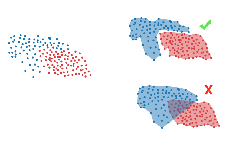

hi, is it possible to create polygons based on points, so that the
polygons can share boundary (ideal case), but can not overlap - see
attached image.
v.hull does not solve the "can't overlap" problem
one possible solution:
1) v.hull
2) v.to.rast
3) r.patch
4) r.to.vect
But not so nice solution
Any hint?
Thanks
Jachym

Maybe concave hull can help?
http://grasswiki.osgeo.org/wiki/Create_concave_hull
attached image.
v.delaunay ?
v.voronoi ?
Depending on how you want the polygons to relate to the points.
