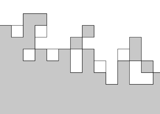

After that, the offending polygons where deleted however, their boundaries are still present. That is, when I load the vector in the map display, I still see the boundaries in some polygons, even though the area is not filled. Is this the intended behavior? I tried using the areadel tool but then the whong polygon was deleted. I’m guessing the shared boundary of a valid polygon was removed and his caused problems.
Attached is a sample of what I’m seeing after v.edit delete

Attributes of areas are linked to the centroid of the area. So the features you select through your query are these centroids, not the boundaries.
It would probably be nice to have a type=area option in v.edit.
To get the same result, you could use v.extract -r type=area.
Moritz

v.extract did the job. The only downside is that I need to keep creating temporary layers since I’ll have to do a series of edits. But no problem. It can be done.
Cheers
Daniel
