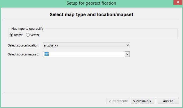

  4. In the Setup for georectification panel I selected the source Location and Mapset (See panel1)
  5. In the next panel (see panel2) I clicked on Create/edit group

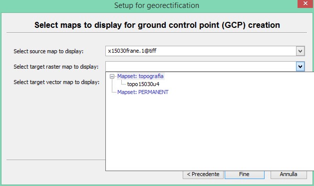

  8. In the next panel (see panel 5) I clicked ‘Select target raster map to display’.
  9. In the correctly displayed map list I choosed the topo15030u4 map as target map (see panel 6).

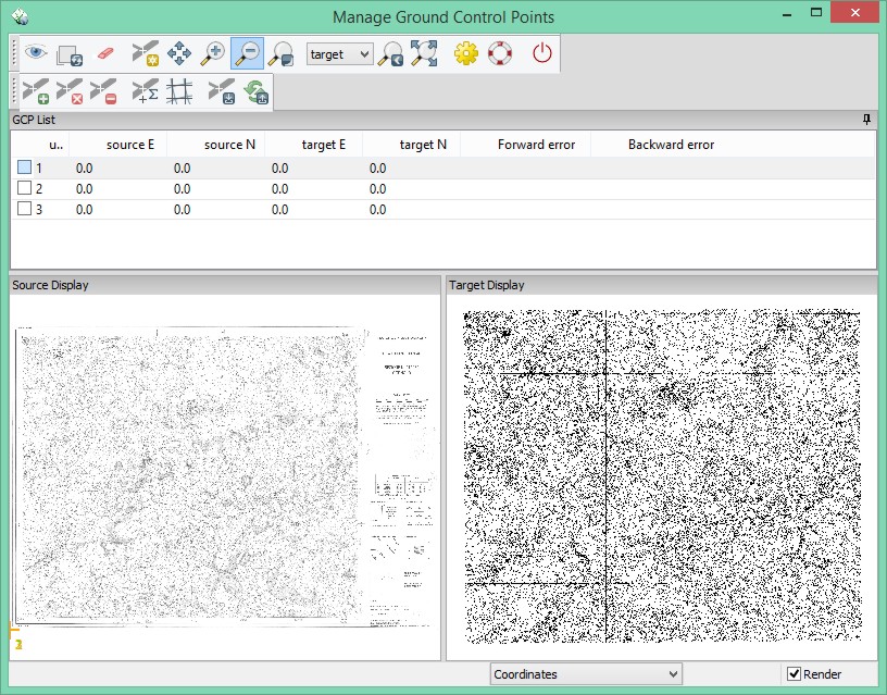

  10. The map name was inserted in the panel (see panel 7) but when I clicked Fine (The Finish button) the ‘Manage Ground Control Points’ window was not displayed and the module seemed to be closed.
Wath is curious is that sometime, when I click ‘Select target raster map to display’ the maps of the source Location (not the target) are displayed (see panel8) and the selection of one of the maps allows the opening of the ‘Manage Ground Control Points’ window (but with the wrong map in the target window, of course) (see panel9)

4) In the Setup for georectification panel I selected the source
5) In the next panel (see panel2) I clicked on Create/edit group

8) In the next panel (see panel 5) I clicked ‘Select target raster
map to display’.
9) In the correctly displayed map list I choosed the topo15030u4
10) The map name was inserted in the panel (see panel 7) but when I
