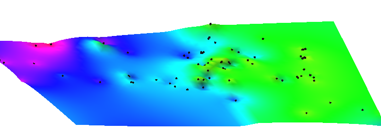

Hello Alec
I did some tests with your file and it worked fine.
Importing the vector into a UTM22south region indeed results in ‘zone invalid’ from v.info, but it works. (even with the ‘override dataset projection’ option)
(note: the data is on UTM zone 22J - Santa Catarina State)
In the 3D view, initially, the symbol size was really small (100 meters - map units) and the extent of the points is quite large 212x367 kilometers) so it was hard to see the vector points. But they are there. In the ‘Appearance’ tab, you can increase this size.
I attached a screenshot of the point (size=1000) and a crude interpolation of the PROF_BASE column.
Given the spatial distribution of the points, I suggest you create a mask of the convex hull (v.hull + v.to.rast + r.mask) of your points and restrict the interpolation to this area.
You might also want to double check the encoding on the DBF file. I didn’t got any of the Portuguese special characters correctly (I tend to run away from using characters like ‘ç’ ‘ã’, etc).
best
Carlos

Hello Alec
